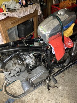

I can’t even start it now.
Dropped the carb bowls and cleaned out. Some small particles in there and rusty looking fuel.
I had been using the tank which I had cleaned out but obviously not perfectly.
Cleaned main jet pilot jet and cold start jet with carb cleaner.
Fitted aux tank which is spotless inside.
Bought fresh fuel.
It fired a couple of times but since then nothing.
Dropped bowls again.
Nice and clean in there now.
I have spark….
Have tried three sets of plugs, Champion n2 and Bosch.
Spins over great on starter but nothing…
The carbs sit on aluminium stubs, not steel, and they are prone to corrosion at the o-rings. It also looks like the original over 50 year old insulators. Have you had these off and checked? Are you sure that the choke plungers are actually opening. It should run on choke virtually regardless of other carb issues. It has good compression in both cylinders?
82385
I have just found I have very low almost no compression on the left cylinder… right cylinder shows 125 psi.
Ok
Oil in left brings compression up from 0 to 120 ish
Oil in right brings compression up from 125 to 150 / 160 psi.
This bike stood a long time. Sticking rings?
Anyway it’s head and barrel off time I think.

Once you've got the pistons, rings and head off and sorted I think you'll find it purrs. Might even need a rebore. DEFINITELY need to remove those old inlet stubs, check the black composite heat insulators between carbs and head (the perish/crack) and replace the four o-rings. Probably still originals! Once head is off, pour some fuel down each port (with valve closed!) and check for leakage past the seats.
