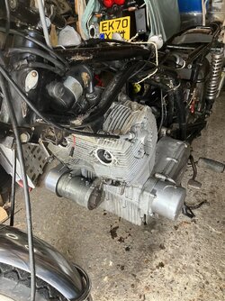

Here’s the engine being prepped for removal. A lot of oil borking out of the left exhaust port.
All engine mount bolts loosened off ok.
I’m acquiring one of those small scissor lift things . Once I have that I can slowly tip the motor forward, remove head and barrels then tip the motor back, pop two more bolts back in to hold in place so I can wheel it all out of the way.
Observe also the carb insulators. They look ok but the o rings are hard and flat which clearly was a problem.
Onwards and upwards!!
