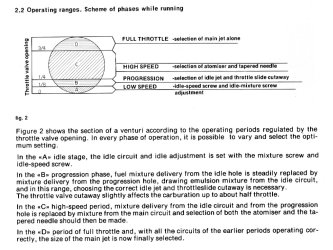

Jetting was all over the place. I have 145 main and 45 pilots with the 265 atomisers and K2 needles. To test jetting you really need to put a registration (white tape or something) on the throttle grip and housing, for quarter, three quarters open. The mains do not com into play until 3/4 (the second handful on an SF with std throttle and 36mm carbs), before that they could be lying in the bottom of the float bowl. Half throttle is the middle of needle/atomiser.

The more open the slides are the weaker the vacuum for the pilot system to operate. Sure, there might be something getting through but compare a main jet hole to a pilot jet hole AND then factor in the reduced pilot system vacuum.

There are a LOT of ambiguities in the language in that manual. take about tortured English. The only way I could understand some sentences was to write them out like a maths equation, with Yesses on one side and nos on the other. There's not a lot of logic in its needle listings either. You might think starting at big and ending in small but not so much. I probably shouldn't complain, at least they tried and I was happy to at least have a hint.
There is a chart with all the needle profiles (is it in that manual?). They definitely do not just gradually get thicker or thinner. Lots of parameters for lots of compensating.
