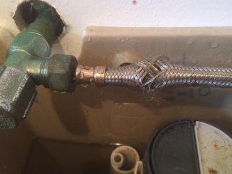

Has anyone come across a burst braided hose in domestic plumbing. It's a typical hose that goes from a stop cock to a plumbing appliance. In this case a toilet cistern. I was sitting at my computer when I heard a "POP!" then the sound of flowing water. It was obviously coming from the toilet cistern and when I lifted the lid, I found a fountain of water, and this - photos below.
I thought these things were supposed to be rated to well above normal domestic water pressure. My water pressure is pretty good but nothing out of the ordinary, otherwise the mains pressure water heater would have a hard time.

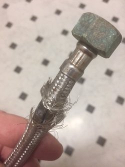

The hose came with a new toilet kit that I installed about 3 years ago. There's another spot on the same hose with rusted and broken strands in the "stainless" braid, and a bulge in the inner rubber tube that probably would have burst eventually if the other spot hadn't gone first. It wasn't kinked or otherwise weakened at either failure site.
The blurb that came with the replacement hose says "This hose must be inspected every 6 months and replaced at the end of the warranty period stated" but there's no stated warranty period. All it says is that the warranty complies with Australian and NZ laws, and "we guarantee this product is fit for purpose".
I have other hoses like this all over the place in the kitchen and bathroom. They've been there for more than 10 years and none of them is showing any signs of deterioration. I'm wondering if the hose supplied with the toilet kit was some cheapo piece of non-rated rubbish just to make up a complete kit.
I have questions: How long do these things normally last? Does anyone really do a 6-monthly inspection and replace them after a pre-determined time?
Happens more than you think Cam…….. your lucky it was contained in the cistern, and not under a vanity! Braided Rubber hoses are still circulating but are on the way out! All new compliant hoses have a Pex ( Poly Ethylene x ) core now.
Manufacturers think if they stick a warning tag that says they must be inspected every six mnths and replaced every 2 yrs, that it covers their ass! It’s no different to Councils placing a sign on a roads verge telling us to beware of pot holes…… Tis enough to shift any possible claims made against them back onto you!! 😤😤
Buyer beware……..
I have seen some of these cheap shit hoses leak, the inner pipe is absolute shit quality that expands like and inner tube if used without the braiding outside it. Best not to use those if sitting with pressure all the time, better to use known brands there but how can you really tell.
APPLIES TO THE UK These flex hoses are not used a lot by professionals, but when they are, they dont usually give trouble for decades, in the DIY instalation market they are much more common because DIY'ers usually do not have pipe benders or cannot use them, ridgid copper connections are the norm, having said that, a lot of modern taps (focets) have very small bore connections and come with braided hoses, again this doesnt usually create a problem.
I would hazard a guess that your hose was crushed by something with a sharpish edge, long before you took possesion of it, and it was only a matter of time before it failed, you probably have already, but take it out and go the the plumbing shop and buy a replacement, and fit it, you can sleep easy after that.

Well known issue Cam, insurance companies well known cause of flooding, know one lady home was completely flooded, as she was away for several weeks, just bought the house in fact. Lads have more pertinent information. Usually chose wholesale plumber supplies ( Swann in Oz ) for critical plumbing items. Bunnings as last resort, though have had decent items from that source also, Cistern fill and drain plastic components with approved water mark stamping and local manufacturer and or supplier packaging.
On the bargain table at bunnings, annealed chrome copper link pipe and roses for cistern to wall connection, no bursting issues there, though too much trouble over quick fit flexible, until the day as you have had there. Bought all the kits on the table, $5 each...bargain! j
I bought the replacement hose from Bunnings. No idea if it's any better than the one that failed. Probably not.
I'm now wondering if I should make up new pipes from annealed copper tube to replace the other flexible hoses in the house. I might not be home the next time one goes.
With today’s international trading it’s hard to tell what quality consumers are getting, but I second the use of Pex for plumbing after using it to replumb my house. But you should be able to find a quality braided hose at a local plumbing supplier.
As I’m away from home a lot, you’ve now got me wondering if I should replace my ones too. I don’t know what they are made of, can only see braid.
