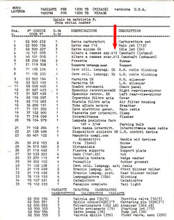

Ventodue Hero member Location France Sep 13, 2023 #41 Ah ha! Thanks, Clem. Even more confusing and complicated than thought, but hey! that's Moto Laverda for you Just for interest, here's that sheet of parts for the "1200 TS Mirage versione USA", complete with A12 cams.
CLEMTOG Hero member Sep 13, 2023 #42 my "variations" parts list and drawings are (presumably) for European markets K28 needles!!! jessus bleeding bloody crickey!!! CLEM
Tippie Hero member Location Dr?bak, Norway Sep 15, 2023 #43 CLEMTOG said: my "variations" parts list and drawings are (presumably) for European markets K28 needles!!! jessus bleeding bloody crickey!!! CLEM Click to expand... Maybe make sense with the oddball AB262 needle jet (edit for Clem, emulsion tube)? Last edited: Sep 15, 2023
a14rgs Hero member Location Wiltshire, UK Sep 15, 2023 #44 FWIW, this is the carb spec for my standard 1977 1200: floats (PHF250) slides (PHF 60/2) needles (PHF K1) needle jets (PHF AB265) idle jets (PHF 55) main jet (PHF 130)
CLEMTOG Hero member Sep 15, 2023 #45 how many dyno runs to get that then Alan? and AB265.... should that not be refered to as an emulsion tube? thats you and Tippie. CLEM
