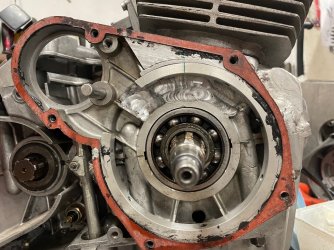

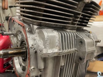

What motivated that weld in the crankcase?
The drilling for the stud on the front right side is put to deep on all three 500 engines iI have had open up to now.
They tend to get cracks there after some life time. I think it also depends on how hard they have been reved.
Not my work. I bought a spare race engine of a German (Horst Scherer, Piet knows him?).
He build a special engine with Honda pistons and outside oil lines to the camshaft’s.
The right side was welded were ever it could. See next post.
It never had run and I had to make it ready.
The bronze bushing works well.

The same engine was welded everywhere at the front and right side.
Look at the ring with bolds mounted.
The first time I rode with this engine it ripped at the backside 😳
Many years ago, I chatted with Tim Parker and mention of the Ogier Daytona winning bike was made. It ended up with with two oil radiators because it was pulling the studs and that was put down to heat.
Maurice Ogier had some re-enforced cases made that were never used. I tried to buy his two bikes and the bits and bobs from him but he wanted more money than I was willing to offer for clapped out barn condition race bikes.
My TT2 which is an ex semi official machine built by Toni Cavazzin with Gianni Sperotto and Toni Rossato had preventive work on the cases.
