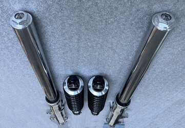

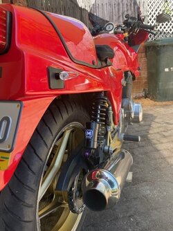

I had Maxtons do my Cerianis, last November. Had them do me a set of rears, too.
A vast improvement on the 47 year old originals, albeit they'd only had oil changes and several sets of seals, over the years.
Brought the steering back to 'as new'.
Done over a thousand miles on them, still fiddling with the many available adjustments.Maxton Suspension 1.jpgMaxton Suspension 2.jpg

Have you any photos of what is done inside your forks? Just curious. I reckon it wasn't cheap either.

No photos of the internal machining, Jim. They fitted the SD20 Cartridges, cost, at the time, £726.75 exc. including the machining.
That equates to three sets of tyres or 85% of my annual fuel cost (for the Laverda).
Feels worth it, to me.

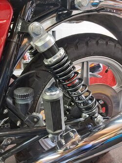

Replaced the originals with a pair of Maxtons piggy backs a couple years ago - huge difference to the rear end. Only problem was I could not fit the piggy backs under the SFC bodywork and had to run them "upside down".IMG_9959.jpg

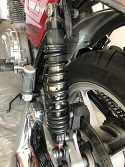

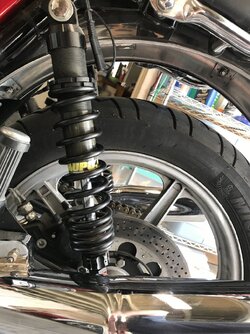

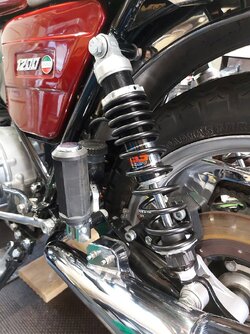

I recently acquired a very well set up low mileage 78 1200 Jota America, it came with MUPO (Italian-built) rear shocks and I am very impressed. The ride is superb and to date, I cannot fault these shocks, I would rate them as excellent. I am seriously thinking of replacing the KONI shocks on my Jota with a set of MUPO shocks. To be honest, before buying the 1200 I had never seen or heard of MUPO. Here is a link to their site.
www.mupo.it
