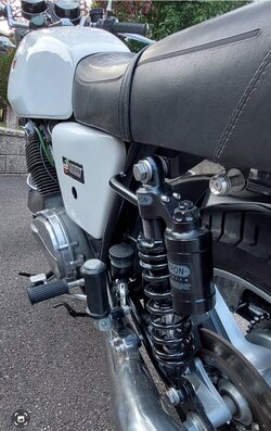

Fitted NITRON's to mine, MAXTON fronts still to go on
