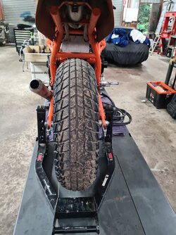

Due to the changing weather conditions Brett and Paul must have done at least a dozen wheel changes over the weekend going from dry to wet Pirelli tyres and back to dry again, we nearly ran out of safety wire
So many thanks again to both of you, could not have achieved our 4 wins without either of you
Photo of a rear wet Pirelli race tyre, work really well if track is actually really wet but an issue with a drying track

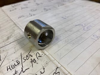

Here's the little sucker problem child.. now to disassemble and find out the cause..:rolleyes:
Maates, bloke kicking hisself.. older type cam bush fitted without the drilled lube hole.. No excuses as I have a box of these bushes but somehow we managed to fit 3 good ones and one 'bad'...
Anyways, we have solutions (hopefully) and will be back.
