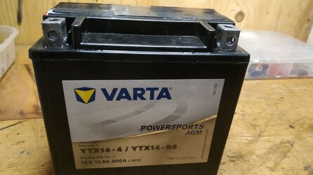

I received as gift this battery. It is an AGM 12Ah. Could it be too weak for my SF1? I run the risk to burn it?
Thanks for any suggestion

Well this is an AGM 12Ah battery. Could it suit on a SF1 with original charging system?
Please just answer yes/no and why would be appreciated. Im just a bit confused up to now

Yes. The standard regulator effectively controls the dynamo output to maintain voltage at the battery terminals at 14.3-14.5v (assuming the dynamo is spinning fast enough to balance the bike's electrical load - around 2,000rpm. See 750 Generator output curve )
This is sufficient to maintain a Varta AGM battery at or near its full capacity.
Obviously it's a good idea to check charging voltage to ensure your regulator is functioning correctly
Make sure you fully charge the battery before first use. This helps prolong its life. Typically it will be supplied at ~80% fully charged.
And obviously make sure you charge it if not used for long periods - all batteries self-discharge over time. AGM batteries are better than wet lead acid in that respect, but do like to be kept fully charged. (12.8v or more across the battery terminals)
Finally - to remove the confusion around regulator / battery sizing. That's irrelevant. What matters is regulator / dynamo sizing. The Bosch dynamo needs to work with an 11amp regulator. This is because the dynamo is rated for 150w output. Overloading may occur if the wrong size regulator is used. Unlike an alternator reg/rect which dumps excess voltage output, the regulator manages voltage output by controlling the current input to the field coils.
Good points Jouni and Rob. I know of people with SF who swear by their 12amp battery. I wouldn't use one because I often end up having to ride shorter trips. The battery you got for free will not damage anything on the bike, the only risk is that it may not have enough in reserve if you do lots of short trips. If you come to the bike one day and it spins too slowly to start it will be push started very easily. My SF has 10.5 compression and it is fine with a 16amp AGM battery no matter what.
So Lovely erda, the answer is yes
Jouni, I have been using AGM batteries for many years now, probably 10.
Lead/acid batteries would die after 3 or 4 years because a plate would drop causing an internal short.
Probably worth mentioning that the SIZE (ie AH) of the battery is more about how much it can store - how many times will it start an SF before its storage capacity drops too low. The regulator controls the size of the 'stream' of amps that are allowed to go to the battery. If you use a 12AH battery it just means the reg will control the stream according to that battery's needs, which will probably be different than if you use a 24AH battery. So the reg may cut in for a shorter time, depending of course on how much you are 'removing' from the battery's storage.
Answer is still YES. :)
