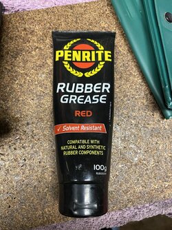

Penrite do a good rubber grease. Smallest i could get here was a container about 100mm OD X 65mm deep.
Judging by previous purchases this will do me for rest of life.
