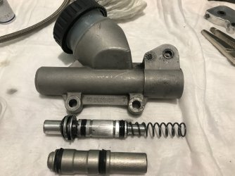

The rear brake on my 78 1200 quit working, meaning it had no pedal pressure. I tried bleeding it, but it was no longer building pressure. The M/C on my 1200 has part number 10 2926. 00 stamped on it, can someone tell me the Brembo M/C rebuild part number I need to order, the piston is badly scored,as best as I can see the internals look good, thanks Dave
Update to my first post, I found a Brembo M/C rebuild kit in a stash I have, it is a 15mm kit which I thought was what the 1200 was, but not when pictured side by side. The old one measures 12.67mm, now I am thinking perhaps it is not the original M/C

I'm pretty sure kits are available. I think Piet said he has some in stock in another thread.
But before you order a kit, make sure the little feeder hole between the reservoir and pump cylinder isn't blocked. That's the usual problem that causes failure to build pressure. It can be blocked by a bit of crud in it or by the piston not retracting far enough to uncover the port when the pedal is released.

Seems to be a M/C from a 500. I have kits for these as well.
While the smaller M/C causes more lever travel, it's probably overall more effective than the larger version.
The rear master cylinder should be 15mm (actually 15.87mm which is 5/8") and uses the same rebuild kit as the front master. The only 12mm (actually 12.7mm which is 1/2") rear master cylinder I have seen is on 120's. I think Piet is correct and you have a 500 master cylinder???
