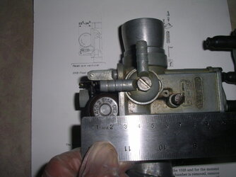

The Green Bk has the diagram 23.5 to 24.5 mil. Obviously this distance is from the bottom of the float to the carb body. Unless there is something I need to know... See pic. The needle would be fully seated @ this position. One of my carbs is off a few mils. Should I take the pin holding the float out to set the needle flange to 24 mils.

Just bend the tabs on which the floats are attached. Takes about 25 seconds. Go for 24mm, or as close as you can get. Having 1mm difference between them sort of defeats the whole exercise.

Float heights have nothing to do with air flow into the carbs.
If your filter is too restrictive, you'll have to play with jets and needle height.
