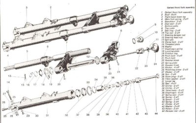

Part number 37 can be very worn and not control rebound damping properly, any lathe operator could spin up new ones. I am on my third set. These are still used even if emulators are installed.
Stiction is a major problem with this type of fork. If you jack the bike up with everything in place on the sliders (wheel, guard, etc) and the springs out, you can check how free it moves through it's travel. If you fill new fork oil you can check the damping in each side by pulling down on both together (with the wheel, guard etc removed), it will show up if they are very uneven.
You said you didn't want to go the upgrade route and despite getting lots of upgrade suggestions you can get them pretty good if everything is as it should be. It is likely to need new springs at this age unless it is very low mileage.
