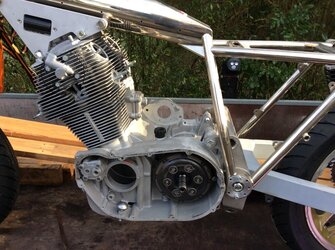

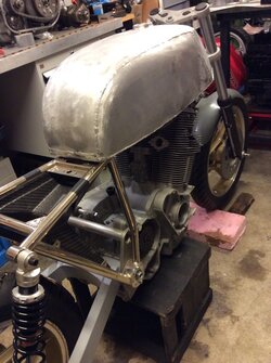

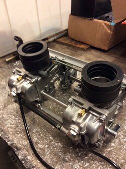

Today I bought my friends project LAVERDA CND 860, now I will build the bike so it
Will be ready for the summer.

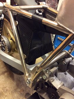

Interesting project Peder, but I'm confused. Is it a replica of the bike that Paul Sharman owned (now Marnix), or was more than one bike produced by CND? It seems a limited run was envisaged, and yours clearly has the modified swingarm fabrication mentioned here

Interesting project,
I do hope though that you are going to either make or have made a new fuel tank, that welding is asking for trouble on a fuel tank. Find someone who can gas weld ally, then the tank won't crack on the seams.

the story of my CND is, my buddy finds projected on Ebay.com, about 5 years ago, where it shows up Sunday night and he's lucky to buy it. I have helped him make various parts that are missing. He was driving tired in projected and I buy it. Yes it is the No. 2 bike that CND builds, I am so lucky that I have the original shape for the petrol tank, where you can see all the measurements and the comments, fun to have, now I want to build it up in the original condition.

270 light crank with SFC centerpiece, inner half webs from a triple and lightened SF outer webs. Arias 85mm hi comp pistons, cylinder head with 42,5 mm inlet valves and 36,5 exhaust valves with 7mm stems, flowed by Mezporting, 38mm Mikuni flat slides, 5/C cam.
