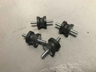

Since drum brake SFCs are full of them, I have custom made silent blocks that flex less, and with the waist, like the original.
Marnix

So finally I found 25 diameter silent blocks, however instead of 20 mm length, I chose 15mm, expecting less flexion. I think I reached an acceptable result.
Something I learned about the hardness of those materials, all silentblocks on the market now a days are around 50 sh?res, which is a meassure of a scale indicating hardness of rubber materials. Specific shocks for automotive industry, are usually around 65 sh?res. Unfortunately they have to be pre ordered and produced, with a minimum quantity of about 100 uds, but the producer said that I would get the same result reducing length by 5mm  :D Just for info.
