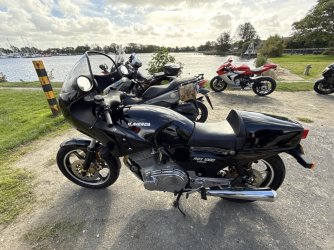

I posted a pic of the “new to me” Corsa - the second of these I have owned in the in the “Out and About” section.
I also inadvertently started a thread regarding the exhaust - so this is the question repeated (hopefully better phrased) to ask for experiences and advice from the Laverdisti “hive mind” on here.
The Corsa is fitted with a 3 into 1 but I find although it’s good and loud, I think the mid range is a bit lacking.
The downpipes appear standard size.
I want to consider putting twin Jota pipes on the bike and would ideally favour mid range torque over top end - more suited to a life on the road. I doWant to use the Corsa not wrap it in cotton wool.
I have an unused Cox 3-2 collector box and some spare headers (standard).
What would you do?
I will consider all suggestions including downpipe size, exhaust supplier, inlet rubbers/ sizes and either for the standard carbs - jet sizes or needle positions as a starting point...
I just want a relatively quick, nice sounding (but not deafening) Corsa with plenty of mid range.

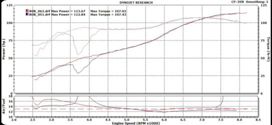

I would spend the money at a good dyno centre who'll tune the flat spot out.
If you were able to see the Air/fuel graph youd likely see it running rich/ lean and thats the usual reason for the flat spot.
Very likely come away with a motor that runs better than it does now overall.
What your effectively doing by changing the exhaust is trying to tune the carbs and if it happens that it runs better, great and if not, you're back to the same place.
Cheers Rob
Heres a screen grab showing a bike fitted with dellortos that were so far out of tune, it took 3 pulls/ re-jets to get to this point dyno pull #51.
There you see the spike in the af graph (super lean) and subsequent loss of power.
Wow. That's one heck of a lean spike on the #51.
What exhaust system was that running?

Its starting with an unknown entity, 3 x 38mm dellorto phm on a tuned motor.
I would say in this case, the exhaust system was irrelevant, could have been 3 into 3. I bought a box of new parts and built 3 carbs with no data.

I notice you have swapped out the clutch and brake master cylinders too - something I will consider, as both are pretty stiff and not that good to use all day.
On my last Corsa I used some AP master cylinders and levers - but these look different... are they the smaller piston later Brembo ones (Guzzi) ?
I believe they are Triumph ones - they were on the bike when I got it - Grant would know
