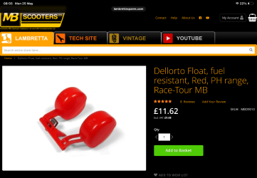

MB in UK makes spare parts for the Dellorto company and he makes his own floats as there is a known problem. He also makes high flow shut off valves. I think these floats are probably too small for a Laverda. Whether Dellorto sub stuff out for obsolete carbs now I don’t know but apparently genuine main jets have hugely differing flow rates- massive problem on a two stroke but still not good an a marginally lean four stroke either.
