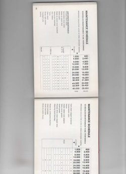

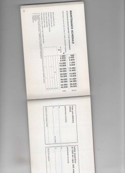

Jouni,
I may have mentioned it here in the past, here you have it black on white...Scan_20260530.jpgScan_20260530 (2).jpg
From the factory owners manual for the 120° models. You will see that replacing the pistons and rings at 48000km is shown in the maintenance schedule. You will also see the factory recommended replacing the entire clutch plate set, rear shocks, primary drive sprockets along with the final chain drive at the same time.
Of course, nobody bothers to do this, not even I... but it tallies with my experience of finding worn top piston ring grooves on pistons of more than approx. 60000km. Stock Marzocchi shocks of the period were knackered within 30000km, final drive chains rarely lasted more than 25000km. The factory was aware of all these issues!
For the non-believers, primary chain replacement, along with a couple of other points;
I've also repaired more than my share of knackered cylinder heads with recessed seats, these also are not a myth.
HTH,
Yes, for example in Germany and possibly in the UK and some other countries fuel still in 1980's had a notable amount of Sulphur. This is also generally known to cause wear on the piston rings, and was a notable factor back in the days, especially if engine oil was not changed when should. Nowadays when there is no such amount on Sulphur, I suggest the same result can be achieved by using fuel with lower octane rating than designed, that is also generally known causing faster wear.
Laverda wanted to sell more parts, and at the end they wrote the shortest found intervals from differing countries in the manual for some components, sort of just in case. In some cases, replacing valve springs every time when opened in RGS manual, I don't find this necessary. Replacing valve springs by kms would be better for some of the the late 1970's heads that use to break springs. I think replacing RGS springs by length measurement would be the normal need if no excess amounts of kms. In some cases, like the pistons, can be replaced according to inspections. In Finland it is normal if taking pistons out, for example, after 150 000 kilometers and the ring clearances are still ok, not causing the engines turning to giant oil pumps. The pistons go back again (usually new rings + honing + old cleaned pistons).
For example, my SFC 1000 was imported from Germany in 2001 and had burned exhaust valves after 10 000 kilometers in Germany, machined, then at 20 000 kilometers it was imported to Finland. I opened the engine, the exhaust valves were burned again, and the base ignition advance was set to 2-3 degrees retarded. I suggest that 95 RON or similar was used without valve guard. I replaced all of the valves, the seats were cut just by touching lightly on MIRA. Base advance set standard, 98E5 in + valve guard. Now after a couple of 10 000kms, just nothing happens and they stay. Not differing anyway from other bikes in Finland that use to have much more kilometers on them.
I think for things like shocks and secondary chain short intervals are normal, and even they can be replaced by inspections.
Personally I very dislike all shocks that are not intended to be maintained by disassembling them. These are generally assembled by pressing methods and even oil is not intended to be changed. I use to drill oil change holes on them and replace the oil, use to go a couple of maintenace rounds.
In Finland the first Laverda importer ordered one kit of spare mass plates for clutches in 1970's. The kit was finally sold in 1990's. The mass plates were also replaced by measuring their thickness, if nothing else was wrong on them.
