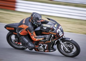

I'm contemplating some fixes and mods. to the 1200 and the most troublesome will be stripping the tank on the inside
It has been epoxied (no idea what with) but being chemically stable (?) what would be a good starting point to remove it. Now, the reason is that the adhesion doesn't appear to be good as it's fractured and flaking on the section over the bike's spine.
A peroxide / organic bath might be an option ... but wondering if anyone has experience.
I'm OK with totally stripping the tank (inside and out) and plan a re-paint anyway.
As to re-paints - planning to re-style and use the Laverda font on the tank .. so has anyone got a link to a supplier for decals / transfers in ORANGE.
If you can't find orange use the decal as a mask over orange paint.
Tis what I do and painted decals look so much better than stickers. Same goes for pin stripes IMHO
Stickers are just tacky :D
