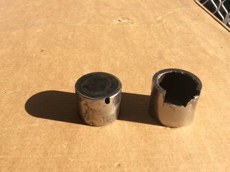

Here is what happens when the desire to oil the primary over the health of the valve train.... left item is when a cleverman decided to linish the radius off the top of cam follower, 'mazing how a laverda will get you home, Canberra to Bowral, the clatter was considerable. Right side, complete low rpm oil starvation from the idiot hole on the oil pump take off vertical gallery....
Hello Bruce, sure the lads will clear up early triple time line.... j
Apparently, early triple pumps are devoid of idiot hole.
In fact, they're devoid of nearly all means of oiling the primary side.
