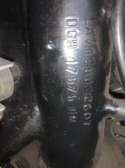

2608 is mine and its a 1200 series 1 TS Mirage
your frame number looks all good to me, do you have the V5C showing that, engine number change at DVLA is as easy as a colour change, frame numbers are the identifying quality of the vehicle and the registration stays with that number, and that frame, hence new frames as spare parts are supplied (or were) with no digits stamped between the stars. Sometimes damaged frames are repaired and 40 years later can create problems, the thinking is always one of theft, or fraud, but the former is very rare in real terms for that, the later...........................maybe more so.
your frame does not appear to have been stamped later, so is factory correct, there are several pointers to indicate that, but I cannot reveal here what they are.
your frame would have started out with fixtures for the later BTZ ignition, but as Red points out it looks now to be for the CDI type, suggesting a change that he thought would never take place, the laid forward shock mounts are stock., there might be 6mm tapped about 20mm OD,welded on bosses for the seat trims,
Highly likely that your bike started as a series 1 TS, but maybe not, again, likely that the first 1200cMirage TS was 2602, which needs differentiating form the 1200TS starting 2567 or the 1200T starting 2534 in those short series of numbers they could have been any of the three types, mine is 2608, which doesn't mean that 2607 or 2609 are identical.

I only had three straps clem otherwise I would have had 2 on each side so that’s that, I’m more interested in what it started it’s life as and it’s year of manufacture , I’m still trying to get the v5 from the old owner
it would have been late registered then, if shown as 1981, yes you can get free tax and no MOT, (but not until April next year) wait untill you have the V5C and then print off a V112 from DVLA (mot exemption form) and take it with your V5C to a main post office or a smaller one that knows what they are doing ( a lot don't) you can get you V5C easily by printing a V62 (DVLA again) and sending it off with £25, V5C in six weeks if the registered owner does not object, he is given that time to react.

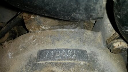

Here's a Spanish engine number for your delectation.
I know they aren't Paul but it's just an example of what's out there. Whatever number is on them they will still be used by me. The bike will still be a Laverda but it won't be worth much with those numbers so I'll just keep it for myself.
