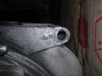

It is a GT engine but plate on frame says Sf. #s are the same. Bought as a parts bike in 1983. Don't know what the deal is. Never looked until 2 wks ago.
Engine & frame #s are 15538 both on plate & engine. Have title in deposit box. Go in later this wk for yr.
If you're comfortable posting a pic of the engine/frame numbers (or post to someone privately) we can opine on whether they've been re-stamped. It's very hard to get stamps to look exactly the same as the factory used, most re-stampings are pretty obvious.

Interesting. The Ian Faloon book says GT's were built 1972-75, numbers in the 4000 thru 16000 range approx. Also mentions that "during 73 and 74 some frames carried the LAV750F designation" (same as SF). So sounds like it's quite probably exactly as it looks, a late GT with an SF stamp.
If it's what I'm thinking, the US VIN plate was issued and attached by the US DOT or whatever. Laverda never fitted a frame plate, only the stamped number next to the swingarm pivot. GT's appear to have had just LAV750*12345*, while the SF's had LAV750F*12345*. The Faloon book says some late GT's (in your number sequence) had 750F designation frames.
If the frame with a 750F designation had been homologated with DOT as an SF, try telling an intractable govt official that it's actually a GT but has the frame designation of an SF... "Nope, it says F so it's an SF and that's what has to go on the plate, paperwork says so".
Seems like it from here anyway. Photos would help.
