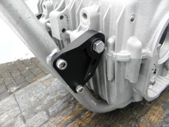

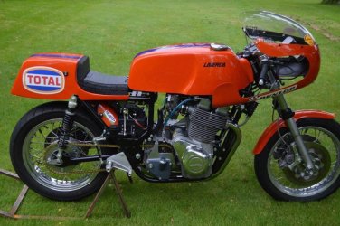

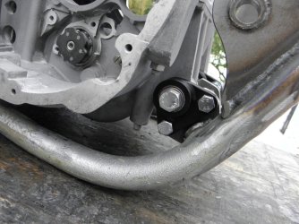

About rubber engine mounts, ween I build my Laverda Endurance racer, with
a SFC 1000 engine, I make my own engine bracket, and it work super, I use
a Honda CB 750 spareparts.

If they can make Ducati bits how hard would it be for Laverda bits if there is a market? Mr SFC Vintage more info on that front mount, please. Does it have a rubber insert for vibration reduction? I wonder how that might work on 180s?
Hi Vince.
Abort front bracket: Yes all have rubbe insert, I have use a racer for : Bikers Classic, so I have use my Engine 👍💪💪.

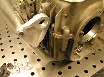

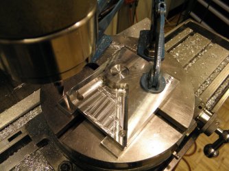

EDIT: quick reply: they do cost 85€ each. Compared to what Andy asks for originally sized ones (127€) that sounds very fair to me. see:
Big advantage of Michael's: they are much lighter and much smaller than the original ones. The whole set weights less than 2 Kilos. He uses them on his TTF1-Racer and has used them on street bikes, too. Seem to work well.
Contact details: http://www.sport-connection.de/ (bottom left you'l find his e-mail-address. He speaks englisch, too).
