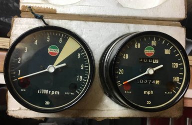

Maybe the light flickering on and off is one of the background lights or maybe even the dreaded neutral light has lost the surround in the clock that keeps the light over the jewel.
As Clem mentioned that light isn't connected on a series 2 bike generally there is not even a globe in there.

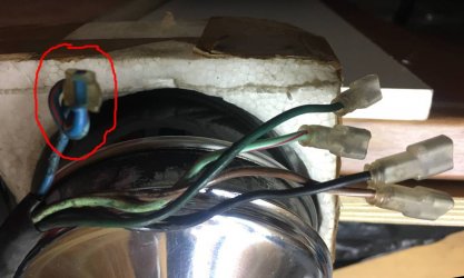

No Gen light function on mine, only the Neutral, Beam and Flash lights were connected on mine as you can see from the photographs below. Blue/red being the Gen lamp, sealed off, from the Factory
