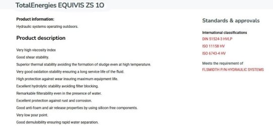

Not having a motorcycle shop in my 'hood and needing to change old fluid what works and is commonly
available rather than the expensive small volume "motorcycle fork oil". I'm sure the oil is not NATO/Mil Spec
magic but allied to hydraulic systems. Collective Brain-Trust Assemble !

My rationale is that I would have to order fork oil on-line and then wait for it in the mail...and at a hefty
cost per cc. I want something readily available at the local auto parts store or hardware that uses the same
formulation. No oil company stayed in business making telescopic motorcycle fork oil in small containers
alone. More oil thread just like Ducati bevel owners from 20 years ago...single grade vs. multigrade ...

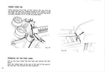

I’m not sure dedicated fork oil was around in the Laverda era? Back in the day Honda specified ATF for their forks. It’s largely bollocks because after about a week in the fork leg it turns to foul smelling grey pissy gunge that bears no resemblance to what you put in.

Fork oil suits seal life, even Arctic seals. Replacing the fork seals is a huge pain; that's typically when you replace the fork oil unless you're sorting other damping issues. Seals wear out Approx every 10 years if you're lucky. I used ATF decades ago, but there are now lots of different types of ATF, so who knows how that goes. A litre of fork oil is $20 here, and that's every 10 years. Do you live a 1000 km from a bike shop or so far from postage, I get stuff from around the world in a week.
I can remember Penrite rep explaining mixing 20w with 10w for 15w as they didn’t make a 15w. Shell rep told me that same 10w40 engine oil was also sold as 10w fork oil & motocross/ racing gear box oil. He also reckoned the top two motor oils were exactly the same but one was sold at a higher price for customers who wanted the best oil money could buy…🤔
