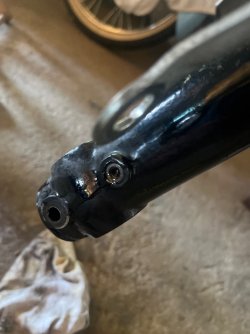

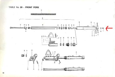

Hi.
I wont to change oil in the front fork but when I unscrew the bolt (see picture one) there only get out a few drops of oil. I also unscrew the the bolt on the top of the fork (see picture two) and there is no oil coming out. What I am doing wrong?
Have you tried clearing the drain hole with a piece of wire?
It might be clogged up with crud.
Either that or there’s no oil in there.
If you know what you’re doing, might be worth dropping the sliders and giving them a rinse out. Fit a new set of fork seals while you’re in there and anneal the copper washer when you refit the sliders.

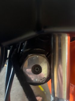

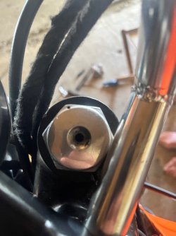

It is a 1972 model, maybe built in the end of 1971. Framenumber 71xx.
I attached a photo of the forks if it helps to see the model (35 or 38 mm).
