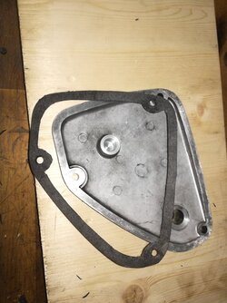

Couldn't wait for a replacement gasket to arrive so made my own from 1mm thick gasket sheet :). Slight adjustment of the eccentric pin 1/8 turn clockwise and bolted everything back up. Just ran the bike up the road neutral to first, first to second & back down to neutral again. Next step to wait for the parts to fix the wobbly exhaust and then apply for the registration.

Good work - but you'll need to confirm shifting in every gear, as they can require some fine tuning to do the full run cleanly. You can check through the gears with the cover off by jiggling the rear wheel back and forth while shifting through.
yep did that all the gears up and down, not been tried out on the road yet as i need to get the bike registered
