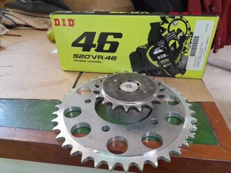

I use a 150 tyre with fuck all chain clearance.
Current 150 Dunlop measures 162mm and is on the chain even though peeling the edge away.
About to convert to 520 chain to gain another 3mm.
Should gain more HP once I fit the Rossi chain

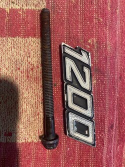

I was never too concerned about the tyres de-beading themselves from original rims after many years ago I rolled the Jota off the stand one day for a ride and realised I had a flat rear tyre. Already kitted up I decided to wobble my way to the nearby servo and top it up, which I did. But the air just ran straight out again and it was then I remembered I'd knicked the tyre valve for a project a month or two earlier! :ROFLMAO: Rode another couple of kays to my uncle's workshop and bludged a tyre valve and some air! :D No issues at all with de-beading.
Putting the matter completely to rest (for me, make your own decisions) was TC getting that M8x100 bolt in through the tread and out through the sidewall of the rear tyre of his 81 Jota. He rode 30-40km back to Crookwell with zero psi and the bike going every which way and the tyre was still firmly on the bead!

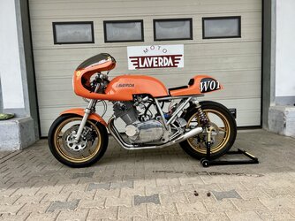

The beauty of these wheels is that they are non-directional, they do not look out of place in the rear of a Laverda with its opposite-side drive. As a bonus, the spoke pattern is quite similar to the Oscams fitted to the SFC1000.
I have used the 750 GSXR wheels in both my 3C and RGS without issues. Especially the RGS is a barge compared to the donor bike, but the wheel(s) have stood up fine over the past 20-odd (is it really that long ago??) years. I now use a 2.75" rim from the 1100 in the 3C, the RGS still has its 2.50". A 150 rear tyre is about the largest that fits without great issues on either a 4.00" or 4.50" rim, a 160 or larger will require the use of a #520 drive chain, preferably of the non o-ring type. The 130/80 on a 4.00" in my RGS works fabulously, nice contour with great mileage from the humble BT45. Current Conti isn't standing up so well.
For additional tyre clearance, a SF750 swingarm can be fitted to a triple. This needs slight mods, but is mostly plug'n'play. The RGS swingarm offers slightly more clearance than the stocker, but is longer and definitely not plug'n'play.
Modifying these wheels is not for beginners and not something that is accomplished on a Saturday arvo while downing a case of coldies. Modifying the speedo drive to fit the front is tricky and a rear sprocket needs to be custom-made.
Imho, the mod is well worth the effort, the dramatic decrease in unsprung weight transforms the old clunkers into decent handling, chuckable toys, offering decent brakes and wide choices of modern(-ish) rubber. Sadly, this will quickly showcase other chassis deficiencies, so the story goes on and on...
