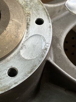

Okay, so I removed a brake rotor carrier and exposed the unpainted surface underneath. I cleaned a patch with scotch-brite and tested with vinegar.
No foaming reaction, which means these particular EPM wheels are aluminum and not magnesium. To my great relief.
I'm not sure if they are any lighter than FLAM wheels but they are intended for tubeless tires anyway. I think. Haven't dismounted the tires. And they are period-correct for an '82 Laverda modded back in the day. This bike will never be 1982-original but it can be 1982-period-correct.
