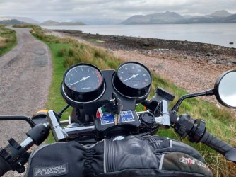

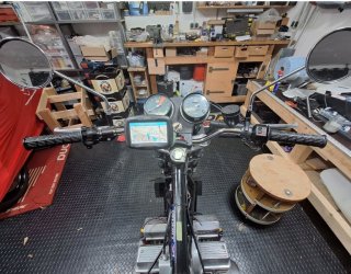

Very appreciative of the feedback and advice, I'm going to try a pair of low rise Renthal bars I've found in black, I reckon they should look good and sit me up, the Look for me is important but being comfortable is the goal, some pics of before, I'll post some after pics 👍20250308_153001.jpgIMG-20250330-WA0000.jpg20250501_155229.jpg
