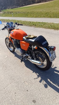

Have you considered moving the bars up? I made the change a few years back.

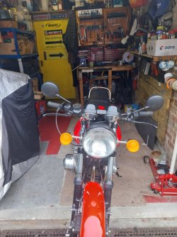

make your own, I did using a scrap Ikea table leg (which was seemless CDS tube!)
this is the second set that I have made for TOG, since for about 45 years I have had to have the right bar in a different position to the left, due to a restricted elbow movement following a seriously bad crash on an SF1 in 1973, I no longer need that so have made a set which is a little higher and is just brill for mega mile days or a bit of city running.
