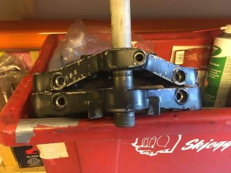

As in SF2
A longer steering stem doesn't make the headlight supports longer. That must be a foreign top clamp you have there Tippie. We're not like that.
Interesting though, we'll have to write another f...ing book.
My SF2 has 35 mm tubes and a flat top clamp.
I have a spare 38mm fork off an SF2 and it has stepped top clamp.
The top clamp on my 3C is flat.
Now for chapter 2: until which frame number was the metal choke lever fitted? Until which frame number was the metal choke lever with facets as opposed to round section fitted?
Tippie said:
As in SF2
Aren't we talking about an SF2, Paul???? I mentioned that the brackets might be shorter on an SF2 than an SF1 and I think it's pretty clear that they are! I have never seen an SF2 that didn't have these stepped Ceriani clamps fitted and I've never seen an SF1 with a stepped top clamp. Even the 35mm SF2 disc models had that stepped top clamp.
