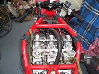

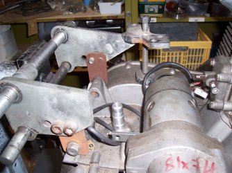

A catch tank is obligatory in Uk racing (and probably everywhere). I also add another breather to the cambox on the triples and, on the 750's one on top of the gearbox casting. I use a "Morini 3?" breather baffle in the added tubes. Don't fill oil right to top of level marks. - Regards - Phil

That's quite a breather set up you have there. I will definitely fit some sort of catch tank while I sort the issue out. It does appear to have rather a lot of oil in it going by the vertical dip stick method. There are 3 indents in the stick, the level is at the end of the last one, so I'm guessing right at the highest of point of the permitted range.
