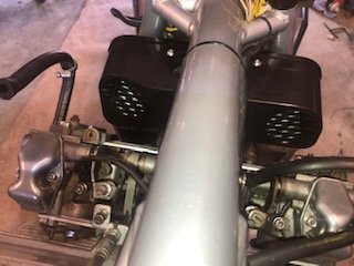

After making and fitting a proper 2 stage foam filter (there was none fitted) along with the new (old) BTZ box, I topped her up with super unleaded and took her for a proper blast. She ran like a dream and ticked over lovely on my return home. RESULT!! Think I?m finally seeing what the fuss is all about. What a pleasure!
New silicone breather hose and catch tank fitted. A tad Scottish, but it was orange, and you can never find a Tango can when you need one!
