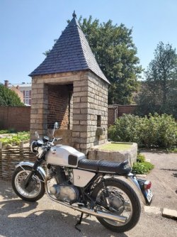

Paul, great image of a beautiful bike!  :) I assume it is one of yours.
Can we trade all of my SF parts for the same S parts???? Huh can we, can we?
My S. I've had it since the early 90s. Restored it after a couple of years use, and never used it. Then divorce, house moves. New restoration after a 25 year lay up and quite a few teething troubles but now, I love it. I need to sort an absurdly heavy clutch pull.
The near unobtainable parts are the brakes and the tank. The rest isn't a problem. Same engine, from memory, as the pre 73 SF.
The S cam is not far off specs for a 5/C. Just back enough that it will run without needing the 2/1 I'd reckon. Always wanted to try a 4S in my road SF motor.
