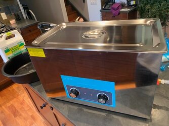

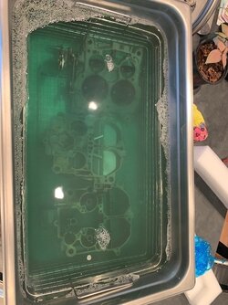

I have had good luck with both of these ....... one is meant for cleaning guns and it works quite well. The Master STAGES CLEAN2020 I bought through Amazon for $103 CDN and it does work the best but the OTIS Ultrasonic Cleaning Solution works almost as well and is only $64. They both work best at max temp on my cleaner (60 degrees C) and usually only need 20 minutes to and hour to do the job. I quickly clean them in hot water ASAP and so far I have not had any discolouration of aluminum. The Master Stages website shows many different version for different cleaning and washing. I am thinking that for volume purchases it would be the way to go.
Jim
Oh, and my spouse has formally bannedthe big ultrasonic from her kitchen...I guess I will have to wait for her to go out.....
