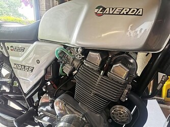

My dilemma is, after 30 years of ownership, I'm pretty convinced now, that the time has come to let my old Laverda 1200 Mirage TS go. I've had it longer than my children, so it's not just like any of my other bikes, which have come & gone. It's been part of our family. But like all things, time moves on & to be fair sadly its just not being used, which is such a shame. last used probably 4-5 years ago now, then stored up. I purchased the bike in 1992 from the original owner, who purchased the bike from Sports Motorcycles in Manchester in 1981, so it has a very short pedigree of ownership. The mileage is genuinely low, being only 30Kkm, which is about 18,600miles. Over the years of ownership, it's had various Laverda servicing, Inc Caldera motors many years ago. I had it professionally resprayed, as the original paint started to blister & looked dull. I still have all the original items, which came with the bike from new, fairings, Koni shocks etc, Inc a set of Krauser panniers / frames which Sports MC fitted for the original owner.
Now my dilemma is two fold, before I just contact the Motorcycle Trade who maybe interested in a classic bike. Firstly, the bike as a result of being stored, unused, the Clutch won't engage any gears! I'm assuming the plates are now stuck fast. I've changed the oil, but still no joy. The bike starts perfectly & runs / idols nicely. I was considering trying to remove the clutch plates to un stick them, but on reading the service manual, this looks a task beyond my technical scope, well certainly beyond the tools I have. The manual pretty much scared me off!
The second dilemma is, I really haven't a clue what its value is?, especially with a clutch that doesn't work / possibly stuck together?IMG_20220703_140114.jpg
What do you suggest all? Sell as is or attempt to fix, but how? Any local knowledge to help in assisting?

I had the stuck plates problem on a 1200TS unused for years, I couldn't get the clutch back to normal until I swapped out the plates. Do that and the value of the bike will be far more than it is with a stuck clutch. It is hard to sell things at the moment mind you.
There is a lot you can do to unstick the plates of the clutch without dismantling, but it is not for the feint hearted and since you say that you are not confident to open the primary chain case, then that may well include you, the value of the bike will drop because of the missing red coach lines by quite a margin.

it does look like a series 1 and they are very rare, (almost all TS's are series 11) I will wager the number is in the 2604 to 2614 region, and if I am correct the primary cover, if it does in the end have to come off) is a very easy thing to do, a bit more complicated if its a series 11 with the ignition buldge on it.
with the clutch sorted. and MOT/tax exemption declared at DVLA, my suggestion is £9500
I will give you £5000 for it
You could try putting the bike on the centre stand with the rear off the ground, start the bike. engage second or third gear and then stab at the rear brake. Have clear area in front of bike or a solid wall or similar in case the bike rolls off the stand!

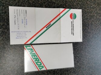

Going through the bikes records, I came across it's original UK Warranty & Service history, from the dealer Sports Motor Cycles Manchester. That was an amazing bike shop, I remember so well as a 16-17 year old, back in the early 80s. It was stocked full of Dream Italian bikes of the day. Laverdas, Ducatis & MotoGuzzi machines, all together, along with Harley Davidson too.
Years later I would actually get to own one of the showroom bikes, my desire had been realised. But now I think its
time for another fan of these bikes to take custodianship, hopefully to the right person who will ride & cherish it. 🤞🏻
