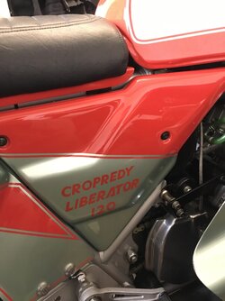

Update: when I put the repaired hose on that the side panel (I guess it's custom like the rest of the Liberator fairing) presses on the hose and deforms it so it doesn't make a good seal and I guess might be why it cracked in the 1st place so I'll look at adjusting that too, maybe a spacer behind the side panel. If I can get the hose sitting properly then I'll just buy a new one. I have found the bike doesn't want to tick over, could be needs carbs tuning after rebuild but presumably air leaks in the inlets won;t help that
You certain that you've got the specific rh one?
Usually, if they don't fit properly, turning them to one side gets them on properly.
They're never going to be leak free.
on a Liberator the bike uses 1200 side panels, IIRC, so the rubbers should fit, the left and centre one's are identical, the RHS one is longer.
dont listen to paul they fit and seal well, fiddly to get the instalation correct, start with the middle one and be sure that the valley on the air box side is corectly located all around, and then the carb side, you can put a cable tie on the carb end if you so wish, then do the left one, same principle and lastly the right, I have seen many carb rubbers kinked were they are not sitting in the holes in the airbix properly.
black silocone can make a good temporary repair to the rubbers, but be sure to scrupulously clean them inside and out with spirit (petrol/ meths/ brake cleaner/ before laying on the silocone
