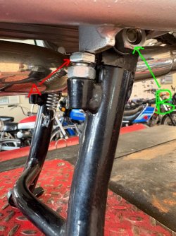

On the question of the stand adjusting screws: do these actually raise the bike, or adjust the angle of the stand? There does not seem to be much adjustment left in mine (see pics).

Screwing 'A' up/out will increase the height of the bike, but beware of overdoing it because you are reducing the over centre which will keep it on the stand.
'B' looks badly wrong. I'd suggest replacing both pivot bolts if they look like that.
It's a compromise between height and stability. If the stand is vertical, it's as high as it goes; if it's pivoted forward, it's as stable as it gets, but maybe too low, and the wheels hit ground. You can cheat by welding a strip of steel to its feet. It's a trick bit of design to hit all targets, high enough to remove a wheel, but not so high that you blow out your back using it. I love the kit that allows a Kawasaki sidestand to fit that is as easy to use as a modern, dont laugh, bike is.

They're meant to adjust the stand to the correct and safe angle. Flat enough to keep the bike from rolling off by itself but steep enough to easily roll it off yourself. This requires only a few degrees difference, your bolts look perfectly normal.
It is important that any slop be removed and the pivot bolts kept tight. Many owners don't understand the mounting system and loosen the bolts to enable the stand to fully retract... this actually makes things worse as it allows the stand to bend and warp when deploying.
The bushes that you SHOULD find in the pivots are meant to be bolted solidly to the frame and the stand should swivel freely around these bushes. If it offers some resistance, it is a sign the stand may be a bit deformed. This usually disappears after a few months of use, the stand is forced back to shape and will eventually work smoothly again. If the bike leans to one side on the stand, the legs are twisted. A looong breaker bar/bit of scaffold pipe helps twist the legs back to near parallel. The stand needs to be securely and snugly fitted for this. Twisting can also be the result of the adjuster screws being adjusted unevenly.
Very often, the pivot holes of the stand are quite worn. These can be reamed a bit larger and over-size bushes fitted to suit. A drop of oil/squirt of chain lube every blue moon may help avoid this wear to a degree. Also prevents those horrible sqeaks!;)
