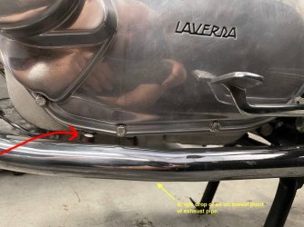

So, I gave the underside a good clean, but haven't had time to give it a run to check to see if I can work out where the weep might be coming from. However, what I did notice was just one drop of oil that had gathered at the lowest point on the underside of the exhaust pipe on the left-hand side.

Are you sure that it's not the tensioner, usual culprit.
Looks a bit like the drop is running down from one of the bolts at the top of the engine cover straight down to the lower left bolt and maybe from there to the exhaust? just look at the mirror like surface of the engine cover and see the stripe... at least it shows on the pic...
Arrowed, Joel.
Holding the locknut, remove the capnut and copper washers.
Holding the adjuster with a screwdriver, undo the locknut and remove the final copper washer.
Heat the washers to cherry red, then quench them, I use waste oil.
Replace, as they were, and see if that's resolved the leak.
