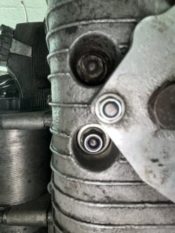

I have a wee dribble from one of the crank case studs next to the oil cover thingy underneath. Do those nuts have a copper washer?
Either way it’s as tight as a crabs arse….
Something I heard recently, a Hardened washer. I guess that's a washer thicker than usual that does not deform. Never heard that before a year ago. I have had issues with Head stud nuts sinking into the head and causing big trouble getting the head off. I really like the idea of spreading loads as wide as possible.
Also good practice to mill where the washer sits so as to keep it flat.
The factory fitted rather thin, weak washers that would quickly deform.
Anyway, there shouldn't be any dribble from the studs unless the case mating surfaces around it are damaged/uneven in some way.
I use thick reinforced washers or flanged nuts to spread the stud tension without further deforming the case where the stud passes through. In some cases, a little machining becomes necessary, especially in cases where the crankcase halves are difficult to separate due to the stud holes contracting under the nut pressure.
The flanged nuts are i ginocchi dell'ape (the bee's knees). The mating surfaces around the four centre studs should be oil tight if sealant was applied accordingly. If no sealant was applied oil will ultimately find its slippery way out.
Had a flanged nut and slightly thicker washer (will need changing for a better nut) so am trying this 👍
