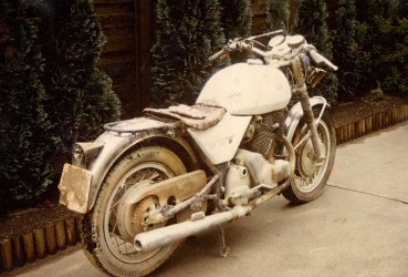

There were no fairings or panniers on any of the Kuwait bikes that arrived in Germany (500, SF2, SF3, GTL, 1000 3C/3CL and 1200, plus a handful of Triumph 750 Tigers).
White overall with the police shield/emblem on each side of the tank, many were fitted with a solo seat.
