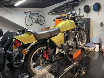

Hi all!
Long time I didn’t log in here! I have been very busy at work and privately… but I managed to finish my last Laverda project!
After struggling to find all parts I did manage to find them all and even to rebuild the head completely😎
I’ll try to post some photos in the end of the post.
Anyway, I have a problem with the shifting, i thought I had set it correctly meassuring both sides as per workshop manual, and in the first ride when downshifting from 3rd-2nd-1st gear, I had to lift a bit the shifter before selecting lower gear.
So I reopen the side cover and readjust the excentric bolt until I am satisfied shifting manually, making sure that the spring moves back the selector to neutral position and makes the “click”.
Well, I reassemble everything, go for a ride… and surprise, same thing as before!! So clearly I didn’t adjust it correctly once again…
Any ideas or suggestions before I start for a second time? I wouldn’t like to have to open it a a third time😕
By the way, it runs super nicely!! Ignitech ignition, new pistons, rebuilt head, monty exhaust… and sound incredible!
Thanks and regards!
Miguel

Nice looking bike. The Stradas look a little out of place. Not a criticism just an observation!
Cheers,
bazzee
Stradas were a fitment on the 500, but I do agree the red does rather clash. However, it’s not a matter of whether it is right or wrong, after all they came red, it’s just, as you say, a matter of opinion.
I completely overhauled them, and decided intentionally to paint them red, with Cerakote. I like them, and they are creating the effect I expected! you are talking about them!!🤣🤣
I really like the color combination but of course that is something personal...
