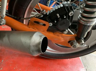

Hi
Please have a serious look at the rear brake setup  :o
The "anchorage" of the caliper holder does not seem very safe.

Are the carbs put on the wrong sides? Why put the shock bolts with the nuts outboard? Is that a standard rear disc? MPH speedo and those gauges? Another allen bolt fanatic. At that price comes pickiness I think anyway.
there are two right side carbs installed... Quality Workshop it was... :o
Bolts on the shocks are an easy fix; sometimes done to avoid them touching the wheel or so (self locking nuts are bigger than the original ones)
MPH-Speedo is original, as the bike was imported from Canada (see text); wonder though if it ever got german papers with that...?
Not sure about the discs in total - shouldn't they be drilled?? or was that on a later model...? No sign of wear on the edges of the discs, so I wonder if they were replaced maybe at a point in time?!?
EDIT: Discs seem to be correct (undrilled). Handlebars are not I think (Tomaselli??). For road-usage in Germany, it would be missing the turn signals; maybe there were some installed, as there are 3 holes on each side of the fairing right where the blinkers were originally.
Pretty sure it was never registered for german road usage. Hope it comes with the canadian papers and the import-papers, else there is virtually almost no chance to get it road-legal...
SFCs never came with drilled discs from new. Many wrong parts and clearly built up by someone who has no (Laverda/SFC) knowledge. Needs correct carbs, dynamo cover, tail light glass, handlebars, switches etc, but still a steal!
