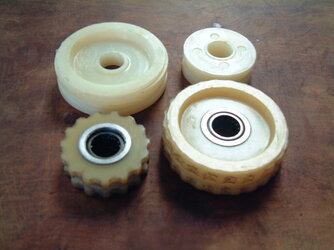

Anyway here is a pic of a worn SFC set and a new set for the SF series

How do i use my lathe to make one of those slipper primary chain tensioners with the rubbery coating, Steve?! Maybe the old GT style ones with the roller but not mine. Is it possible to have the coating replaced on a worn one? If Red's guy can make kevlar clutch plates surely this is doable?

What species of plastic do you use Steve (assuming you use plastic)?
My Kawasaki has a plastic sprocket as a cam chain tensioner wheel. I dunno what kind of plastic it is but the bloody thing wears away at a prodidgious rate. Last time I replaced one (was not actually on my bike that time), I considered making a new one out of steel, or maybe bronze, but I didn't have the equipment to cut the sprocket teeth. Maybe Kawasaki (and Laverda) chose plastic so it's sacrificial and doesn't wear the chain.
I used some nylon, can't quote you the grade. The slightly yellow off-white if that helps.

Dug these out from deep storage.
IIRC circa 1980 they came out of a SF3 I brought in Melbourne
Minus a front end.

Delrin machines nicely and has decent bearing properties.
We used to use Ertalyte for heavier loads and abrasion resistance at a scientific instruments manufacturing firm I worked for.
Consequently, it might be better for the later type tensioner that rubs.
