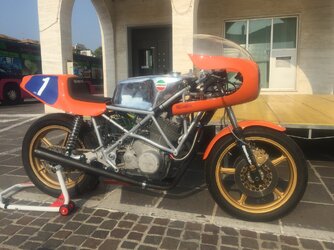

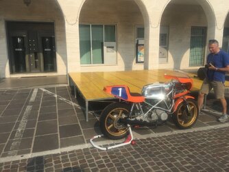

It would seem that Brettoni built his own F2 bike using a trellis frame, which I assume was not a Harris frame like the ones used on the SFC600, and possibly won the series in 1982 or 83?
Separate to the factory effort, although apparently with factory support, Team Cavazzin ran 3 Geminiani framed specials, one of which is now owned by Paul Marx. One of their bikes and riders, Stefano Pagnozzi possibly won the series in 1983. Stefano is also seen pictured riding a hill climb prepared bike that is different again, but the engine looks a bit like the one in the TT2 Laverda Corse have in their collection.
