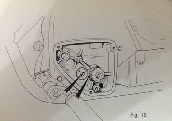

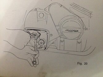

I have never seen one that would select gears just with fingers on the selectors. There is a quite strong spring keeping things in place. Look at an engine diagram.hi Sock it goes into neutral nice and easy can get all the gears with just my fingers on the shaft no problems just first![]()
Hard to select stationary / easy just prior to stopping, most times was a dragging or similar clutch issue, times past, perhaps notching on the clutch outer drum triangle splines, for what that is worth. jnot that it really helps ... I had the 'where's first' issue after totally unrelated (head) work and now have a 'where's neutral' issue
fiddling the selector adjustment solved 'first' but I still need to find 'neutral' at about 2 mph / kmh before stopping
otherwise a crisp, clean shift
my point being that LAVS seem to be very finicky in every respect ... so some perseverance / tweaks generally work

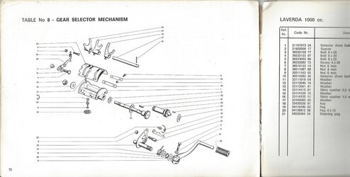

Are you sure the pin for first, n° 20 on the diagram is present. They can fall out, particularly if the washer n° 13 is absent.hi Sock it goes into neutral nice and easy can get all the gears with just my fingers on the shaft no problems just first![]()

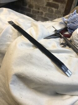

Pull it out, split cases and see WTF is stopping it! Report back and ….. Hurry Upupdate!!!!! I've taken out the Cam chain tensioner as the sock suggested and the blade is there can't see the chain so it's in one piece also can select second to top with no problem with just my fingers on the shaft nice and easy, so I guess it's time to think about taking the engine out and have a look at the gear box internals, or any other things to try before that![]()

with the cam cover off, undo the one cap screw and copper washer that retains the tensioner blade (adjuster loose as can be) and lift it out, a complete blade will have a portion of steel not lined at the bottom, when fitting new these have to be bent slighty to clear the chain, if it not done a lump can "wear" off and cause selector rotation problems, with the cam cover off, you can also see the other side, there is a plastic guide, not removable without lifting the head and cylinders, but there is space to see down there with a borescope, or maybe a torch and mirror, it lies the whole length of the cylinder block.
