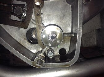

Coming in from left field I had a situation where the end of the return spring worked its way into a position where the leg moved into the gap between the quadrant and the centering pin preventing the quadrant from making its full movement and consequently not making gear selection. Thereafter I always checked the angle of the open end of the spring to make sure it was clear of the quadrant. In this particular case the coiled end of the spring was free to float from side to side altering the position of the open end. As a safety measure I shimmed the coil end to prevent end float. Problem fixed.

There is a note in Andy Wagner's manual about bending those legs slightly Chris to clear the gap in the mount, I did that and managed to twist the orientation of the spring. I replaced it after my attempt at that bend. Didnt try that again. Those spring legs can block the gear change if they get in the way.
... that has happened to me (spring interfering with the quadrant movement)

Wow. This thread just saved my day - after a long time ( 1 year for reasons of being 3000K away) I took the Laverda out for a test run and it wouldn't shift up to anything north of Neutral or 1st. I had last year adjusted the shift mechanism as the eccentric locking nut had worked loose. I should also mention I changed out the Neutral selector switch under the engine with a new one at some point after that? So... today - I took off the gear selector side cover and tried to hand select gears while watching and still no success. Just seemed stuck. Then I came in here and found this thread about "Have you removed the neutral switch? The plunger might not be retracting, and stopping the selector from rotating past it.".
I went back out to the garage - removed the NEW neutral switch I had installed last year and voila - I can hand select gears through the range. The top of the neutral switch showed fragments of brass where it had been meeting some force (e.g. shift attempts). Thinking I may try the old neutral switch or space the new one lower. Next up is to adjust the gear selector eccentric w/out the Neutral switch in the picture. Get that right (using the 4th gear method of adjustment). The weird thing is I would have test ridden after the neutral switch and the gear adjustment so not sure why it didn't have a problem 1 year ago but did today. Oh well. Thanks and I'll keep you updated on progress.

I cured the issue of the spring fouling the selector arm and eccentric adjusting pin by grinding a subtle groove in the eccentric that prevents the arms from moving laterally - has no effect on spring tension. prior to that i was using a thin custom-shaped 'shim' to keep the spring away from the dreaded gap.Selector eccentric customise.jpgSelector spring retainer.jpg
I've been messing around with clutch, chain and gear selector adjustment on-and-off all summer, trying to resolve constant gear change issues, changes up or down often requiring two or three stabs. A replacement selector dog-leg spring has sorted it, the original had gone soft and very loose on the shaft. I now have a very sweet gearchange. This was a cheap and easy fix, so is worth eliminating if you're having issues.
