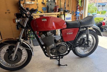

Making progress on my '74 3C

Front and back ends are done and lighting is sorted. Got a Shindengen SH775 reg/rec on the way from a friend who buys, tests, and sells them for a very fair price. I'm hoping that and the LED headlight bulb will do the job, charging-wise. I am pushing in the next 2 weeks to have it together and running, but my Norton and Suzuki need a bit of love too, so we'll see. Gotta get polishing the engine covers, see ya!

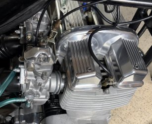

Started right up after a long sleep, tag on plate says 2005. The middle carb float bowl needed a few raps from a screwdriver handle to set things right, as it was drooling. It’s laggy at idle with a quick throttle blip. Nothing dramatic. That fart at 0:34 wasn't me, I'm looking at you, carb #3. Exhaust isn’t smoking, pipes are all the same temp, plugs look good.
It’s not putting out any volts out to the reg/rec, so that’s an issue to resolve, but at least it can be ridden around to bed in the brakes, do a plug chop, etc. Par for the course with these old E systems, as many here have informed me.
